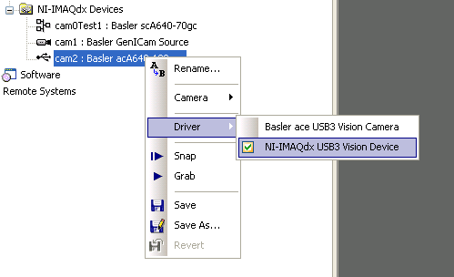

  1. Now, open NI Measurement & Automation Explorer (MAX) and right-click your camera under NI-IMAQdx Devices. Under the Driver» sub-menu, there should now be an option to associate the camera with either the NI-IMAQdx driver or the original manufacturer driver. Change the camera driver you are using when you need to use the camera in your manufacturer's proprietary software instead of NI MAX.
