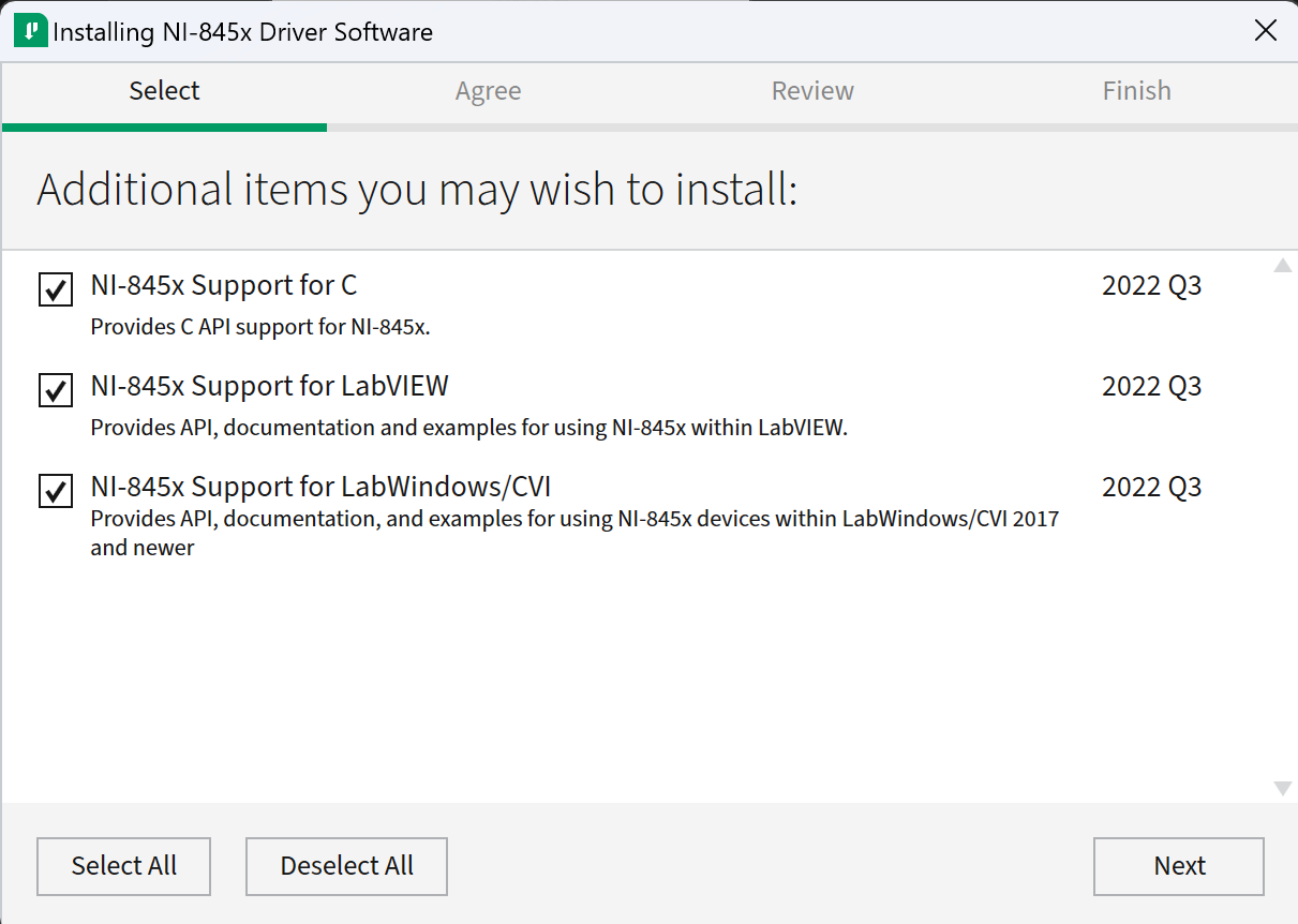

How do I use my USB-845x with a C/C++ Program?
When installing the NI-845x drivers , check that the LabWindows/CVI Support option is checked.
Once installed, you can find example programs on calling the NI-845x API from the following directory: Start Menu >> All Programs >> National Instruments >> NI-845x >> Examples.
Similarly, you can find documentation on function definitions in the Documentation folder.
You can find ni845x.dll in the <Windows>\System32 folder (for x64 systems) or the <Windows>\SysWOW64 folder (for x86 systems) in Windows.
The header file, ni845x.h can be found at the following directory: <Program Files(x86)>/National Instruments/Shared/ExternalCompilerSupport/C/include
