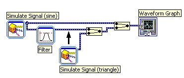

Merge Signals
When you wire a signal output to the wire branch of another signal, a Merge Signals Express VI is automatically created on your block diagram. The placement of the Merge Signals Express VI, however, is dependent on the direction you wire the signals. For example, if you wire signal output B to the wire branch of signal A, the Merge Signals Express VI is created at signal A, as shown below.
Figure 2. Merge at Signal A
However, if you wire signal output A to the wire branch of signal B, the Merge Signals Express VI is created at signal B.
Figure 3. Merge at Signal B
You can also use the Merge Signals Express VI to add another signal to two or more signals that are already merged together. Take the picture below, for example.
Figure 4. Existing Merged Signals
If you wire the new signal directly to the existing Merge Signals Express VI, an additional input is created for you automatically, as shown below.
Figure 5. Wire to Existing Merge Signals VI
However, if you wire the new signal to the wire branch of one of the existing signals, a second Merge Signals Express VI is created.
Figure 6. Wire to the Branch of Existing Signals
Note: The final output to the Waveform Graph will be the same in both cases.
