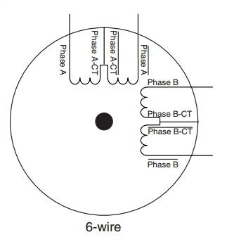

Unipolar motors typically have two coils per phase, one for each direction of magnetic field. Bipolar motors typically have one coil per phase, and current flows in both directions through this coil. Thus, of two motors of identical size, the bipolar motor will be able to produce twice as much torque, since at any given time, the unipolar motor is only using half of its windings. A typical 6-wire stepper motor connection diagram is shown in Figure 1.

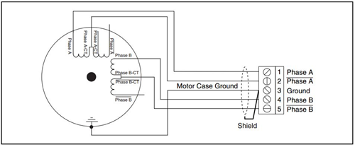

Figure 1 : Full Coil Unipolar
Unipolar Configuration
6-wire motors have three wires per phase. Two wire leads connect to either end of one phase with a third wire connected to the center point between the coils as shown in Figure 1. This third wire is commonly referred to as the phase's center tap. To connect the motor for unipolar operation, the six wires are configured essentially as an H-bridge.
Full Coil Bipolar Configuration
There are two methods to connect a 6-wire motor for bipolar operation. The first method is simply to leave the center tap leads disconnected and connect the motor as you would a normal 4-wire bipolar stepper motor. This type of configuration is shown in Figure 2 and is sometimes known as a full coil configuration as the drive will be energizing the entire coil of each phase.
Figure 2 : Full Coil Bipolar

Connect a 6-wire motor in this configuration by connecting only one side of each phase along with the associated center tap leads as shown in Figure 3.
Figure 3 : Half Coil Bipolar
