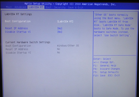

  • For PXI-818x, 819x, 810x, 813x and 811x controllers, you can reset the IP address in BIOS.
  1. During boot press the <Delete> key to enter BIOS setup
  2. Navigate to the LabVIEW RT section of the BIOS setup
  1. Highlight Reset IP Address, press the <Enter> key, and select Yes from the sub-menu
  2. Exit BIOS saving changes

The Startup VI is causing connection issues:
The Startup VI could be broken, corrupted, or consume high CPU resources causing the RT to lose communication with the network. To validate this, test the network connection with the Startup VI disabled. This can be done from the BIOS configuration as shown in the image above:
  1. Highlight Disable Startup VI, press the <Enter> key, and select Yes from the sub-menu
