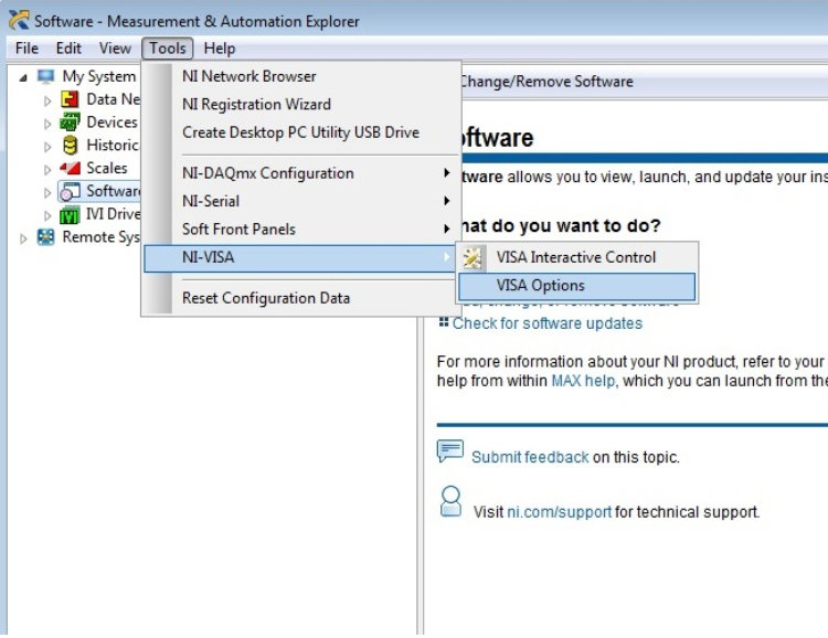

This issue is resolved by ensuring that the NI-VISA Passport for GPIB is checked in the VISA Passport Options. To do this follow these steps:
  1. Open MAX and select Tools»NI-VISA»VISA Options

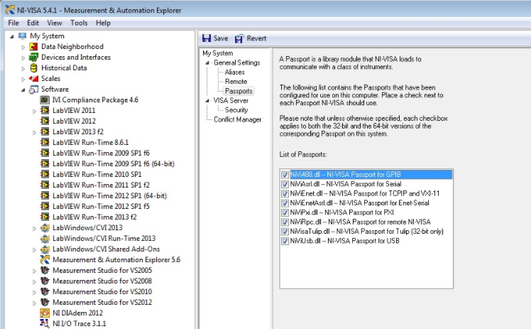

  2. In the VISA Options tab, select Passports under General Settings. Then ensure that the NiVi488.dll - NI-VISA Passport for GPIB is checked.
If it is already checked, ensure that your VI's and drivers are correctly organized on your computer.
