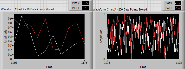

Waveform Chart History for Scalar Values
When a scalar value or a 1D array of scalar values is wired into a waveform chart, the Chart History Length indicates the number of data points, per channel, that the waveform chart will store and display when running. This can be seen in the following screenshot, where two separate history lengths (10 and 200 points) are selected for the same data:

The waveform chart history length is per channel. Therefore, it does not affect the display of multiple plots. For example, assume the Chart History Length is set to 10 data points. If you plot a 2D array of scalar values representing multiple channels of data, then the waveform chart will store 10 data points for each channel (or plot), as can be seen in the first screenshot.

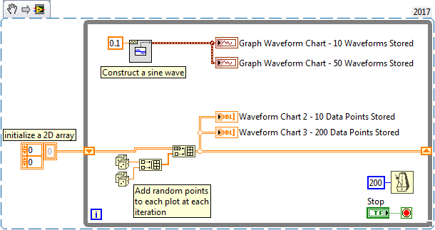

The above screenshots are from the program having block diagram as below, which consists of a simple generation of a sine wave and random numbers and plotting them on various graphs:
