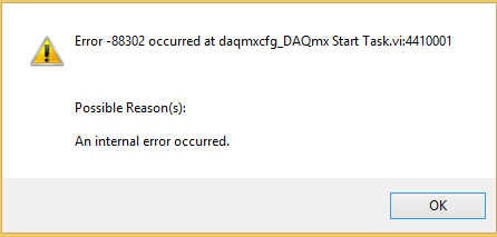

When communicating with my DAQ device, I am seeing one of the following errors:
Error -88302 at DAQ Assistant.  Possible Reason(s):  An internal error occurred.
Error -88302 occurred at daqmxcfg_DAQmx Star Task.vi:4410001
Possible Reasons(s): An internal error ocurred
Error -200486 at DAQ Assistant.  Possible Reason(s):  Specified channel is not in the task..
The self test failed. Status Code: -88302. An internal error occurred.

LabVIEW and NI MAX
To resolve the issue in LabVIEW or NI MAX either repair the current DAQmx driver that is installed on the system, upgrade to the latest supported version of DAQmx or force reinstall NI Software.
A similar error -88302 could also occur with another type of card, such as a DMM PXI card, or HSDIO PXI card. In those cases, the corresponding driver would have to be repaired or reinstalled. For example: NI-DMM, or NI-HSDIO, respectively.
If the issue persists even after uninstalling the relevant driver, try uninstalling and reinstalling all NI software. As a last resort, try reimaging the machine if possible.
