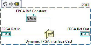

To create subVIs for reuse purposes, use the Dynamic FPGA Interface Cast primitive to cast a generic FPGA reference to a reference with specific FPGA items as seen below. This works well in tangent with the solution above to mitigate broken wire errors.
