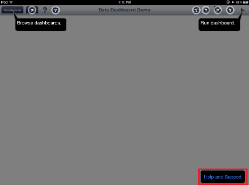

  • In Data Dashboard 2.0 the data type support is described in the App's help:
  1. Click the ? on the left hand side of the toolbar.
  1. Select Help and Support in the bottom right of the overlay.

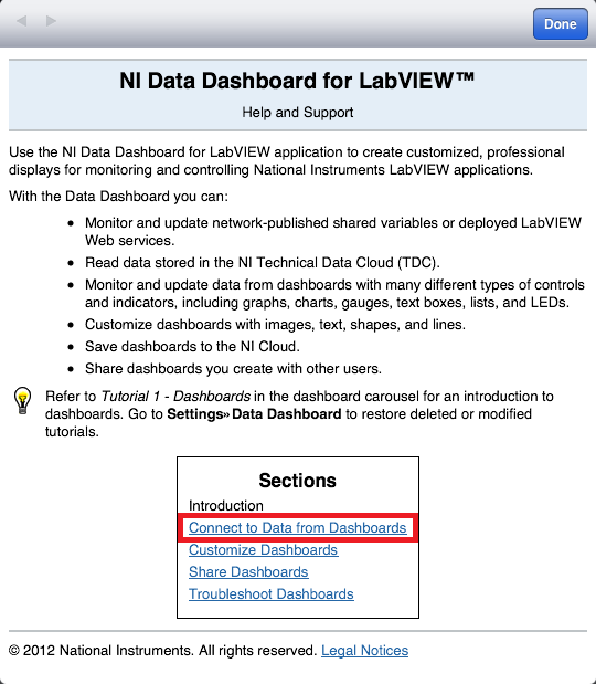

  1. Select Connect to Data from Dashboards to view supported data types.
