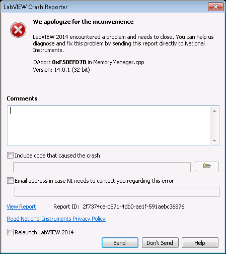

When running an analog video acquisition in NI Video Measurement Suite (VMS) (Legacy), or other LabVIEW programs, my application crashes with the error message:
DAbort 0xF50EFD7B in MemoryManager.cpp.
If using VMS and LabVIEW or TestStand:
This error is related to the version of NI-SCOPE you have installed with the NI VMS software. In the particular case where you have NI-SCOPE 14.1 installed, trying to run an analog video acquisition will cause this memory error message to appear.
The NI-SCOPE driver causes the crash if you attempt to run any LabVIEW-built DLL or executable that was built with an earlier version of NI-SCOPE. Since VMS is an application based on LabVIEW, this crash is related to VMS attempting to call NI-SCOPE functions when running through TestStand or LabVIEW.
Returning to the 14.0 version of NI-SCOPE doesn't present this behavior and should resolve the problem. Be sure to uninstall the NI-SCOPE 14.1 Runtime in addition to the main driver component. You can also upgrade to NI-SCOPE 15.1, which is the first version to include a fix for the issue.
