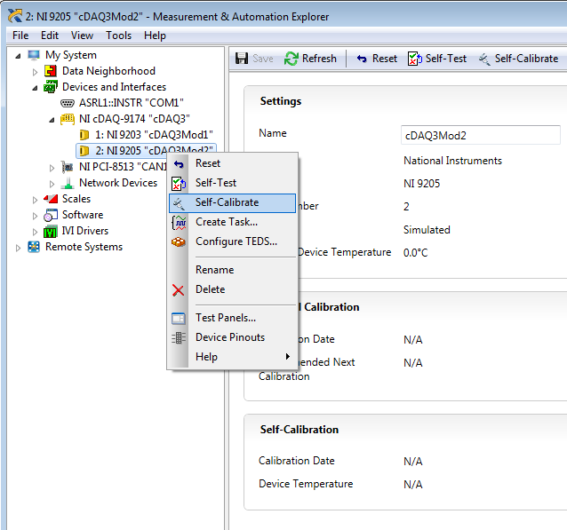

I have a DAQ device and am unsure if I can self-calibrate it. How can I check if my device supports Self-Calibration?
You can quickly determine whether or not your device supports Self-Calibration by using Measurement & Automation Explorer (MAX). This software is available on Windows machines after installing the full version of NI-DAQmx. It is also included with many of our other drivers.
MAX can be found by going to Start >> Programs >> National Instruments. Once you have opened MAX, expand Devices and Interfaces, right-click on the device you want to check and you should find an option to Self-Calibrate your device. Select Self-Calibrate. Self-Calibration will complete if it is supported, otherwise it will throw error -200445. See the picture below for how it should look.
If you want to check for this functionality on a specific device, or do not have MAX installed, the information about Self-Calibration can also be found in the product manual for each device.
