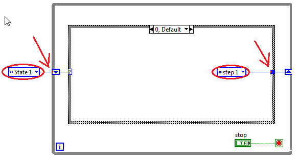

  • I use Enums to select different states in a case structure. When I make changes to the Case Structure and the Enum, some or all of my case labels are reverted back to numbers.
  • When I try to run my VI, I get a broken run arrow with an error stating "LabVIEW cannot update from type definition without incorrectly preserving default value." Some of the Enum selectors within my cases are grayed out.
  • A small red coercion dot appeared after editing the Enum selector for my case structure. What causes this?
The input into the case selector determines the labels for the Case Structure. If there are different types of inputs wired to the case selector, the labels will be set as general as possible. For instance, if the items of the Enum outside of the While Loop are different from the items of the Enums inside each of the cases, the Case Structure cannot determine which type should be displayed for the labels and therefore displays numbers. LabVIEW also might display a small red coercion dot and/or gray out some of the enum selectors within the cases.
