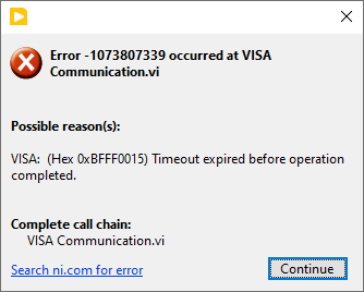

When I try to communicate with my instrument in LabVIEW or in VISA Test Panels, I get the following error:
Error -1073807339 occurred at VISA <function name>.vi
Possible reason(s):
VISA:  (Hex 0xBFFF0015) Timeout expired before operation completed.
This error occurs when NI-VISA expects to receive a message or response from a device, but that message is not received within the timeout period, or at all. This error is commonly caused by improper physical connection, incorrect communication settings, or using commands that the device does not recognize. This document will walk you through the process of troubleshooting each component of your system.
