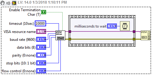

  • Verify that the port has finished its configuration by the time the first character is received off of that port. You can do this by putting a delay (approximately 10-100 ms) after the VISA Configure Serial Port VI to allow the serial port enough time to configure itself. Then, by using a VISA Flush I/O Buffer VI, you can clear any invalid data in the buffer. Reading after this sequence should work correctly. Your block diagram should appear as shown below:
Note: This image is a LabVIEW snippet, which includes LabVIEW code that you can reuse in your project. To use a snippet, right-click the image, save it to your computer, and drag the file onto your LabVIEW Diagram
