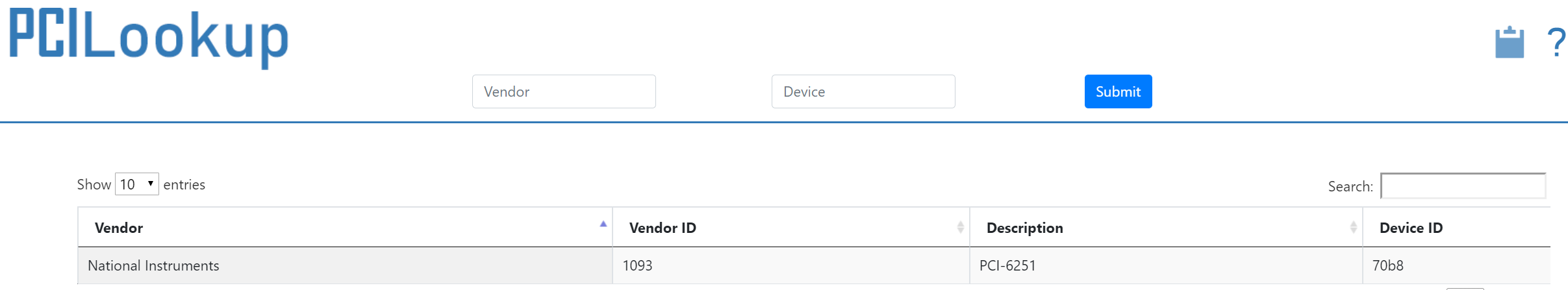

  1. Identify which device corresponds to the PCI Simple Communications Controller by determining its Vendor ID and Device ID.
    1. In Windows Device Manager, right-click on the PCI Simple Communications Controller and select Properties
    2. In the Details tab, when selecting the "Device instance path" or "Hardware Ids" Property, there should be an entry similar to PCI\VEN_XXXX&DEV_XXXX&… The numbers after VEN and DEV indicate the Vendor and Device ID, respectively. For example, PCI\VEN_1093&DEV_70B8 means the Vendor ID is 1093 and the Device ID is 70B8.
  1. Look up your device on pcilookup.com to identify the vendor and the device description. For example, the above VEN and DEV values give the following result.
  1. With the vendor and device information identified, if the hardware is from NI, then follow the steps in Windows Does Not Have a Driver Associated with Your Device Error in MAX to identify and install the driver for your device on this table. If the hardware is associated with a different vendor, please look to that vendor for the most appropriate installation steps.
