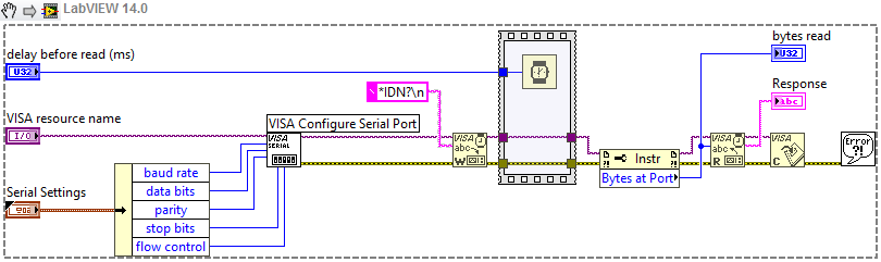

When examining LabVIEW’s serial communication example (located in NI Example Finder under Hardware Input and Output > Serial > Simple Serial.vi), you’ll notice that it begins with a VISA Configure Serial Port node. This node sets up both the termination character (which defaults to hex 0A, representing “linefeed”) and the timeout (which defaults to 10 seconds).

When using the following configuration of VISA Read:
VISA Read using Bytes at Port property
The Byte Count terminal of VISA Read is equal to the "Bytes at Serial Port" property. You may encounter the following error/status code:
Status Code 1073676294 (Hex 0x3FFF0006):
The Number of Bytes Transferred is Equal to the Input Count.  More data might be available.
You can learn more about it the following article: Error 1073676294 (Hex 0x3FFF0006)  from VISA Read in LabVIEW.
