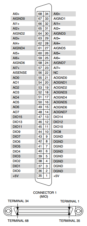

The default analog input terminal mode is differential (DIFF). To correctly measure a differential signal, use the AI+ and AI- pins of the device. For example, use pin 68 and 34 as shown in the figure below to measure a signal on the analog input channel 0 differentially.

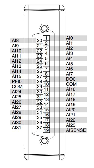

It's also important in differential configurations to confirm whether you also require a connection to COM ground following the guidance in Table 1 of the document Field Wiring and Noise Considerations for Analog Signals. As an example, the following DAQ device measuring a differential floating signal would need to have a channel connected to AI0 (+) / pin 1, AI8 (-) / pin 20, and COM, with each consecutive pair (pins 2 & 21, 3 & 22, etc.) for a given channel also connecting to a COM pin.
If your application requires single-ended measurements, configure the analog input channels to reference single-ended (RSE) or non-referenced single-ended (NRSE). See the NI R Series for USB Getting Started Part 2: Advanced tutorial for information on how to configure the analog input terminal mode programmatically or through the project explorer.
You may refer to How to Determine If an Input Signal Is Ground-Referenced or Floating should you need to clarify whether the source is ground-referenced or floating, which impacts whether you need to connect to COM on a DAQ device.
