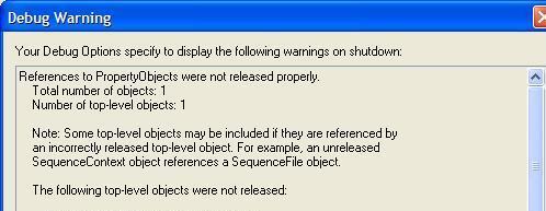

When I shut down my TestStand UI, I receive a warning that PropertyObjects were not released:
I am doing one of the following:
  • Using a LabVIEW User Interface (UI)
  • Running a TestStand sequence that contains LabVIEW code which converts an ActiveX variant wire to a property object.

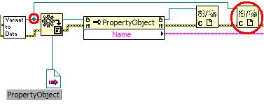

      • When you use the attached SubVI, you will need to use it in addition to the Variant to Data VI that is already converting the variant. Also, be sure to close the reference that it creates as shown below in Figure 1.

Variant wires can also hold references to PropertyObjects. However, variants cannot be closed explicitly, and will not be freed until the VI leaves memory. Please note that this issue has been fixed in LabVIEW 2014, and the following code change is not necessarily in LabVIEW 2014 or later.
By moving the conversion between a variant and an ActiveX reference to inside of a dynamically called VI, the variant data will be freed since the VI will be removed from memory upon completion of execution.
