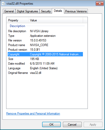

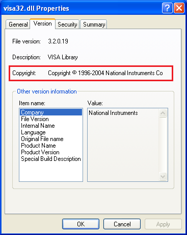

  1. Navigate to the appropriate directory below based on the bitness of your OS and locate visa32.dll:
    • 32-bit systems: C:\WINDOWS\system32
    • 64-bit systems: C:\WINDOWS\sysWOW64
  2. Right-click on visa32.dll and select Properties.
  3. Find the copyright information:
  • On Windows Vista/7/8/10: Navigate to the Details tab:
  • On Windows XP: Navigate to the Version tab:
If the copyright information states National Instruments, then NI-VISA is set to be the primary VISA on your system. If another company is stated, then follow the steps below to make NI-VISA primary.
