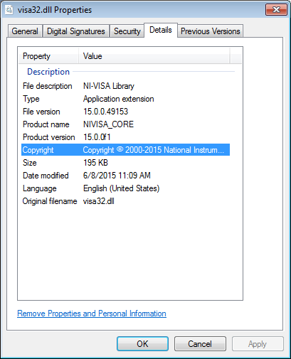

  2. Right-click on visa32.dll and select Properties.
  3. Find the copyright information:
  • On Windows Vista/7/8/10: Navigate to the Details tab:
  • On Windows XP: Navigate to the Version tab:
If the copyright information states National Instruments, then NI-VISA is set to be the primary VISA on your system. If another company is stated, then follow the steps below to make NI-VISA primary.

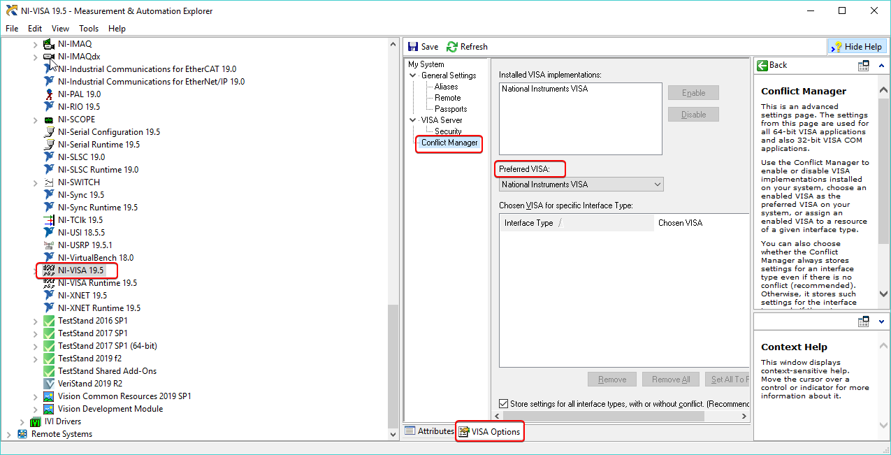

Option 1: Set VISA as preferred in MAX
  1. In MAX, expand the Software tab and navigate to your version of NI VISA.
  2.  Select the VISA Options tab at the bottom of the window and then Conflict Manager. Under Preferred VISA, select National Instruments VISA.
