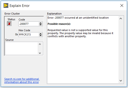

Error -200077 on the USB-6008
Updated Oct 26, 2018
  • USB-6008
When I run any examples to do analog output on my USB-6008, I get error -200077 at the Timing properties.
Error -200077 occurred at the Timing properties.
Possible reason(s):
Requested value is not a supported value for this property. The property value may be invalid because it conflicts with another property.
The USB-6008 does not support Sample Clock Timing for analog output only Software timing. Change the timing to "On Demand"
