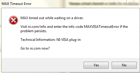

When I launch Measurement and Automation Explorer (MAX) or interact with options within MAX, I receive the following error.
MAX Timeout Error: MAX timed out while waiting on a driver. Visit ni.com/info and enter the info code MAXVISATimeoutError if the problem persists.
The MAX VISA Timeout error is a general error that is thrown when MAX makes a VISA call, but does not get a response from the driver. Follow the steps below to resolve the error.
