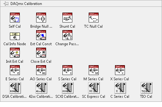

Additionally, NI-DAQmx includes high-level function calls to simplify the task of writing software to calibrate devices. DAQmx Calibration VIs and Functions are available in LabVIEW to perform both internal and external calibrations. For information on these VIs, refer to the Help Manual information:
DAQmx Manual: DAQmx Calibration VIs and Functions.
Figure 1 - DAQmx Calibration Functions Palette in LabVIEW
As the calibration procedure manuals describe, the DAQmx Intialize External Calibration VI, DAQmx Adjust Y-Series Calibration (where Y is series of the device), and DAQmx Close External Calibration VI are used to perform the calibration using LabVIEW. More information about these VIs can be found in DAQmx Help and LabVIEW Help.
