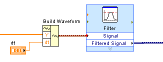

  • An array of data is being passed to the filter without waveform information:
If you wire an array into the input, most filter VIs will automatically place a Convert to Dynamic Data Express VI between the array and the input. The new dynamic data will not have time data. The filter needs to know dt (the time between samples in seconds). You can configure an array into a waveform by adding a Build Waveform VI to your block diagram as shown below. You can then specify dt, and connect the resulting waveform to the filter VI.
