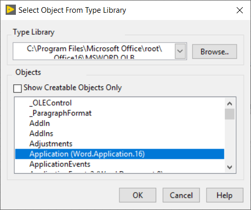

When using the LabVIEW ActiveX built in functions:
This behavior happens because LabVIEW is not linked to the needed Microsoft Object Library or there is a difference in bitness between Microsoft Office and LabVIEW. In order to do so, follow the next steps:
  1. Right-click the Word._Application or Excel._Application reference to display its options.
  2. Go to the Select ActiveX Class option, then, click the Browse… option.
  3. Once the Select Object From Type Library window is displayed, click again on Browse…
  4. Follow the path where the Object Library is located, for both Word and Excel the default path is C:\Program Files\Microsoft Office\root\OfficeXX\, where XX is the version number
  • For Word: Its name is MSWORD.OLB.
  • For Excel: It will be necessary to change the File Type selector to All Files (*.*) to be able to see the intended executable, its name is EXCEL.EXE.
  1. Once you load it, you will be able to select the Application (Word.Application.XX) or Application (Excel.Application.XX) option, where XX is the version number.
  1. You might need to click OK and follow steps 1 and 2 again so LabVIEW can load the options from the library.
Refer to External Link: About Office: What version of Office am I using? for steps to check the bitness of your Microsoft Office installation.
While it seems possible to use LabVIEW 64-bit with Microsoft Office 32-bit, it is recommended to have matching bitness between LabVIEW and Microsoft Office.
