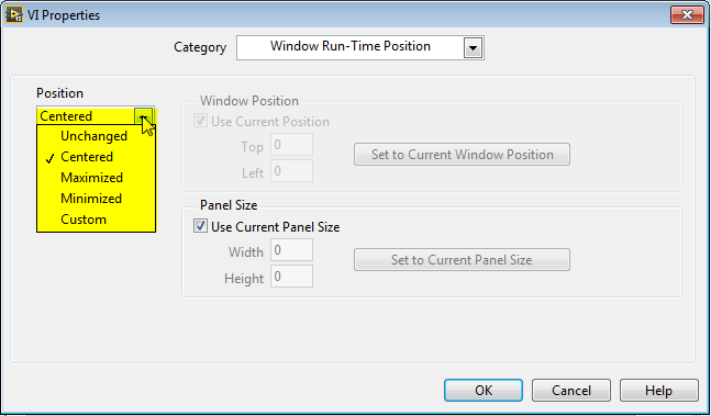

I am building a stand-alone application(EXE) to run on other computers/different systems that have different number of monitors and different resolution monitors. I want the window to be centered and visible on all of these monitors. How can I achieve this?
You can set the run-time position for a given VI or EXE to be centered or set to another position by going to File>>VI Properties>>Category: Window Run-Time Position. The position of the window can be set in the Position drop-down window as shown in the Figure 1 below.
Figure 1. VI properties Window Run-Time Position
