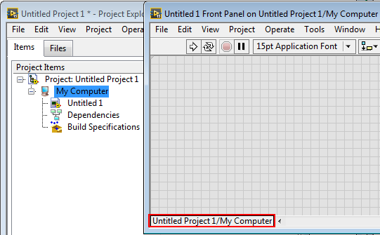

  • Check to make sure the VI is set to run on the correct target you are expecting.​  In the image below, the VI is set to run on My Computer.

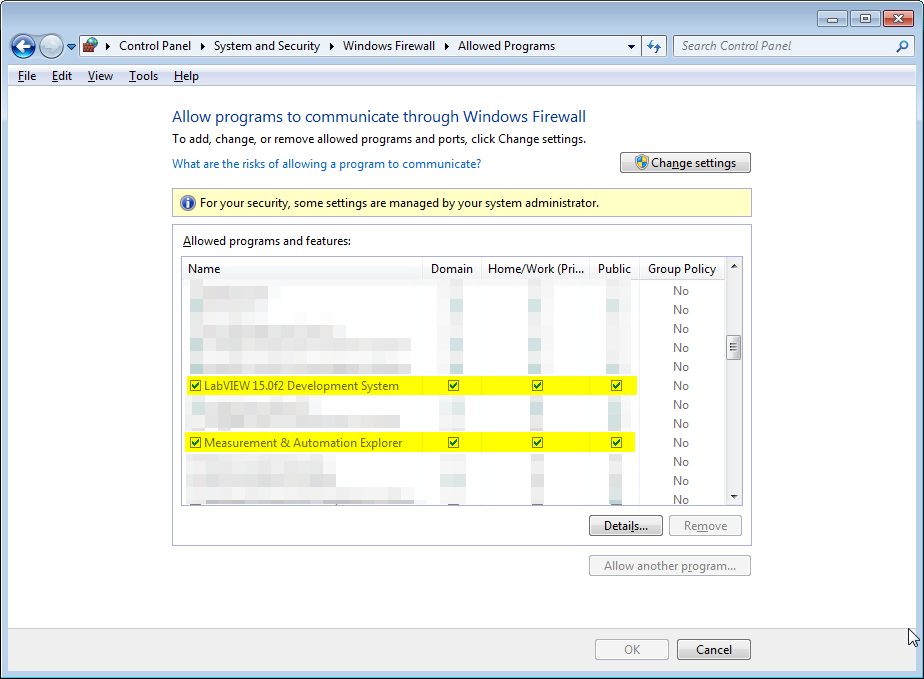

  • Try disabling your firewall.  If that works, make sure that you have allowed proper permission for LabVIEW in your firewall.
