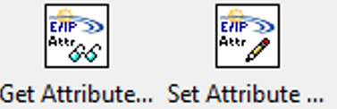

  • For communication with any EtherNet/IP device using the generic CIP messages, you can use EthernetIP CIP Get Attribute Single.vi and EthernetIP CIP Set Attribute Single.vi

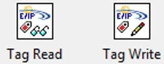

  • For communication with Rockwell PLC specifically, you can use the EthernetIP Tag Read/Write VIs
