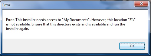

The Microsoft-Installer (MSI) which is used while installing NI Software automatically tries to access these directories. If the 'My'-folders are located on a Network-drive the MSI cannot find these folders in the default directory on your PC and the installation is aborted. However the installation could be performed by a system administrator with full administrator rights.
Otherwise you could change the registry entry on your system, that the installer uses for the corresponding 'My'-folder on the local PC. In order to change the registry entry perform the following steps:

- A dialog window appears and you can change the value from Z:\ to %USERPROFILE%\. Click OK and re-run the installer.
- The installation should now proceed without the previous error message.
If this does not solve the issue, the better solution is to let the software install by your IT-administrator.
