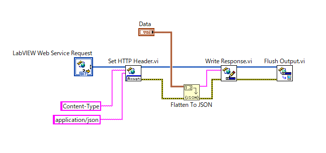

I want to create a method VI in my LabVIEW Web Service that sends out a response as JSON format.
I know how to configure the terminal output of a method VI to send a response as JSON format, but I do not want to use terminal to send out a response.
How can I send a response as JSON format from my method VI without using its terminal?
You can use combination of Set HTTP Header.vi, Flatten To JSON.vi, and Write Response.vi .
To send a response as JSON format, set "Content-Type" header to use "application/json" using Set HTTP Header.vi.
Flatten To JSON.vi will convert your data into a UTF-8 JSON string, which you can input into Write Response.vi as a body of the response.
