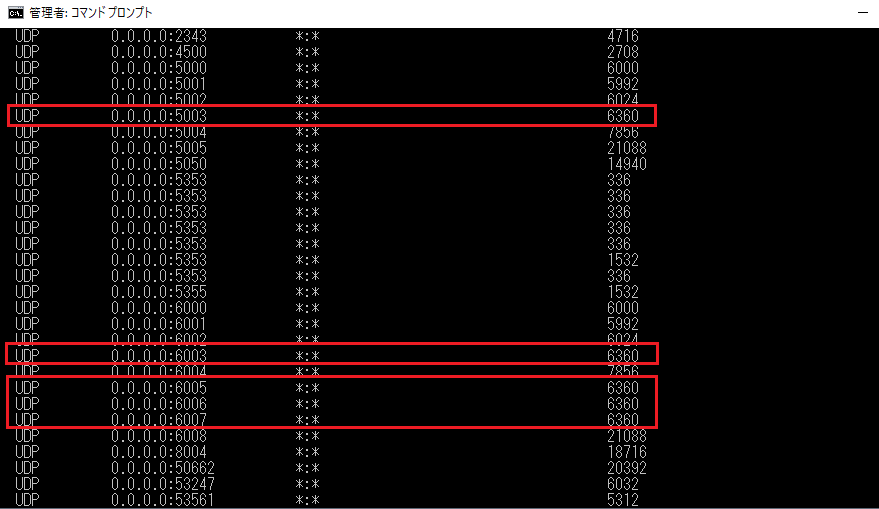

For example, Shared Variables and Network Streams use TCP port 2343, UDP ports 6000-6010, TCP ports 59110 and above by default. You can monitor the exact UDP ports it uses by running netstat command in command prompt to display active connections.
You can see below that UDP ports 5003,6003,6005, 6006, and 6007 are being used by PID (process ID) of 6360.
The corresponding process to the PID can be found from Task Manager or using the Tasklist command.
If you need to use a specific UDP port that the NI service is using, you can temporarily disable the service to release the UDP port so that it is free to use. Once you enable the NI service again, the NI service should attempt to find an available UDP port to use.
