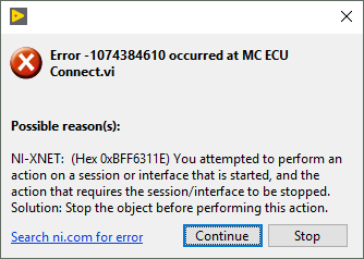

I am running multiple NI-XNET or NI ECU Measurement and Calibration (ECUMC) sessions on the same CAN port and get following error:
Error -1074384610: You attempted to perform an action on a session or interface that is started, and the action that requires the session/interface to be stopped. Solution: Stop the object before performing this action.
This error can occur when:
  • You try to run multiple CAN sessions (XNET or ECUMC) with different baud rates on the same port.
  • An XNET Session or ECUMC Session of the opposite type is already started on the interface.

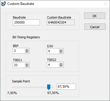

To set the baud rates:
The baud rates must be the same for all XNET or ECUMC sessions that run on the same CAN port. You can either modify your DBC or A2L database or use the properties above to align the baud rates at runtime.
The values read from XNET or ECUMC might indicate basic baud rates  (e.g. 125k, 250k, etc.) or custom baud rates, which are represented by either hex or decimal code (e.g. 64A004160F, 217432985111, etc). When your are using custom baud rates, you also need to align the sample point value and the bit timing registers. This information is already included in the numeric code of the custom baud rates. You can use the NI-XNET Database Editor to calculate the hex code of your custom baud rate.
A common source that leads to error -1074384610 is, that the A2L file specifies a custom sampling point, which forces the NI ECU Measurement and Calibration Toolkit to use a custom baud rate:
If NI-XNET is used and the A2L file specifies a sampling point for the baud rate which differs from the sampling point used internally in NI-XNET, ECUMC replaces the standard baud rate value by a custom 64-bit baud rate which uses the sampling point as close as possible to the sampling point in A2L database. You can find the documentation for the NI-XNET custom baud rate in NI-XNET Hardware and Software Help under Interface:64bit Baud Rate.
In this case you can reconfigure your XNET session to use the same custom baud rate or simply remove the sampling point specification from your A2L database, which allows ECUMC to use the basic baud rate. Look for the following lines in your A2L file and remove or comment the property SAMPLE_POINT:
BAUDRATE 0x7A120
/* SAMPLE_POINT 0x28 [remove or comment this line]*/
