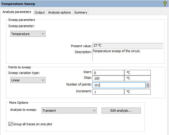

The Temperature Sweep is found in the toolbar Simulate>>Analyses and Simulation>>Temperature Sweep, as is seen in the following image:
This Temperature Sweep allows you to verify the operation of the circuit at different temperatures.
