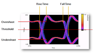

For a real eye diagram, as show in Figure 2, we can first see the average erise time (Rise Time), fall time (Fall Time), Overshoot, Undershoot, and other basic level shift parameters such as Threshold/ Crossing Percent of the digital waveform.
Figure 2: Level shift parameter

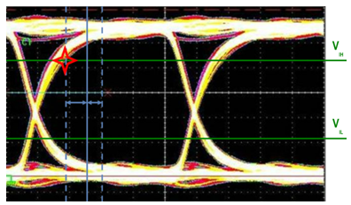

Before and after sampling, the digital signal needs to have a certain setup time and hold time. The digital signal should be stable during this period to ensure correct sampling, as shown in the blue part of Figure 5.1. For the input level decision, the high level voltage value is required to be higher than the input high level VIH, and the low level voltage value is input with the low level VIL, as shown in the green portion of Figure 5.1. Therefore, we can know that the earliest sampling time and the latest sampling time are shown in Figures 5.1 and 5.2.
Figure 5.1: Sampling and judgement a
Figure 5.2: Sampling and judgement b

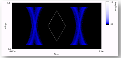

In the actual test, in order to improve the efficiency of the testing, the method often used is Mask Testing. That is, according to the requirements of signal transmission, an area (such as the diamond-shaped area in Figure 7) is specified on the eye diagram, and all the left and right signals are required  to appear outside the area. Once a signal appears in the diamond area, the test fails.
Figure 7: Mask Testing

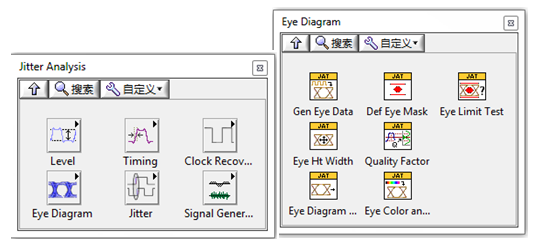

LabVIEW also includes the Jitter Analysis Toolkit VIs, which offer VIs for clock recovery, eye diagram measurements, jitter measurements, level detection, jitter signal generation, and timing measurements.
The correlation display analysis function of the eye diagram is shown in Figure 8, including eye diagram display, Mark Testing, eye diagram parameter calculation. The detection of other parameters mentioned in the paper can find the corresponding function in the board of clock recovery, jitter measurement, level detection, jitter signal generation, timing measurement, see Table 1.
Figure 8: Jitter Analysis Toolkit
