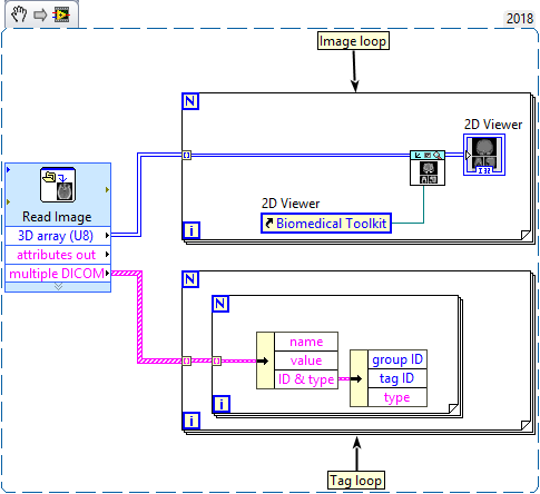

To access each Tag of each image is required to read the matrix multiple DICOM tags out.
The following code access each Tag of each image and visualizes each DICOM image using the 2D Viewer of the Biomedical toolkit.
