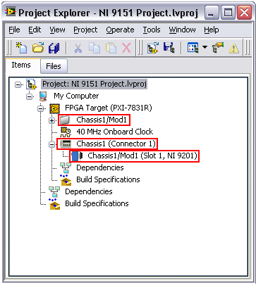

To configure your LabVIEW FPGA application to recognize the C Series modules in the expansion chassis, do the following:
For LabVIEW 8.x and later
- With the expansion chassis properly cabled to the R Series device, power up the PXI controller or desktop PC system.
- Create a new project or open your existing project.
- Right-click on My Computer in the Project Explorer window and select New»Targets and Devices... Then, select Existing Targets and Devices, select your R Series Device from the list and click OK.
- Right-click on the newly-created FPGA Target under My Computer, and select New»R Series Expansion Chassis.
- In the dialog window that appears, select the connector to which you have cabled the NI 9151 expansion chassis and click OK. Optionally, choose to discover C Series modules now. Otherwise, add them in steps 6 and 7.
![](/servlet/rtaImage?eid=ka0VU0000003CxV&feoid=00N0Z00000HEWRt&refid=0EM0Z000000tYUY)
- Right-click on the newly-created Expansion Chassis and select New»C Series Modules...
- Select Existing target or device, expand C Series Module, select Continue when prompted to halt FPGA code, select all of the detected modules, and click OK.
- Right-click on the newly-created modules and select New»FPGA I/O. Add all of the desired Analog and Digital I/O and click OK.
![](/servlet/rtaImage?eid=ka0VU0000003CxV&feoid=00N0Z00000HEWRt&refid=0EM0Z000000tYUd)
