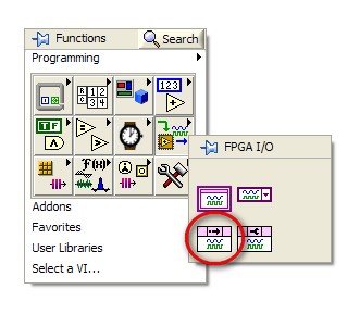

- Add an FPGA Method I/O Node (FPGA I/O Panel) to the block diagram.

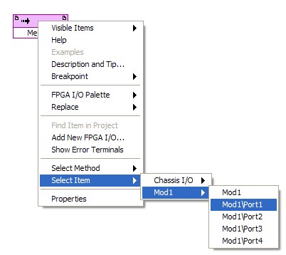

- Right-click the node, and choose the module and port from the Select Item menu.
- Select the method you need to use.
