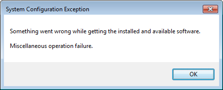

I'm trying to install software to my Linux Real-Time Controller, but receive one of the following errors:
Something went wrong while getting the installed and available software.
Miscellaneous operation failure.
OR
How can I resolve these errors and successfully install software to my system?
