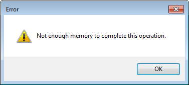

I am trying to build an application from a LabVIEW project, but I get a Memory is full or the following error message during the build process:
 Not enough memory to complete this operation.
The error occurs when the LabVIEW compiler run out of memory, especially when it tries to compile large or complex VIs. There are several methods that could potentially resolve the issue:
On a 64-bit Windows operating system, LabVIEW (32-bit) can access up to 4 GB of virtual memory without modification. LabVIEW (64-bit) can use up to 16 TB of virtual memory on a 64-bit Windows Operating system. If using LabVIEW 64-bit, the LabVIEW 64-bit Run Time is required on the deployment end. Most toolkits and drivers are available for 64-bit LabVIEW, but a small amount are not. More information about specifics of which modules and toolkits are compatible with which bitness of LabVIEW is available in the LabVIEW 32-Bit vs. 64-Bit Development Environments FAQ.
