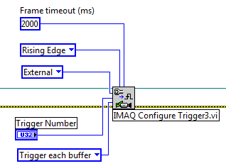

Triggering the Frame Grabber Only
When triggering only the frame grabber, the camera will operate in free-run mode. The camera will constantly collect and send images to the frame grabber. When the frame grabber is triggered, it waits until the next time the FVAL line goes high and then reads the next image from the camera. When all of the image data has been sent from the camera, the FVAL line will go low and the frame grabber will wait until triggered again. While waiting for the next trigger, the frame grabber will not respond to the FVAL line.
To configure the trigger in LabVIEW, use the IMAQ Configure Trigger VI.
