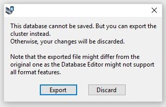

While trying to save my .dbc file in NI-XNET Database Editor, I see the following message.  Why can't I save my file?
Press the export button, and select the file path of your database.  It will save it by overwriting the previous database with your new one.
The native file type for NI-XNET Database Editor is .xml.  Creating or overwriting a file of another type requires use of the Export function.
