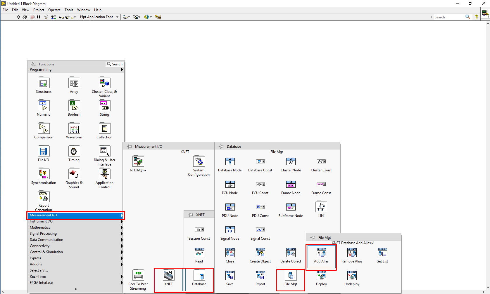

If you have the NI-XNET Runtime driver installed on the target machine, you will have to create the alias programmatically with the XNET Database API (Measurement I/O >> XNET >> Database >> File Mgt), using the function shown in this image:
