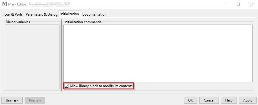

Follow the procedure below to make the compilation with active library links successful:
  1. Right click on the library block and select Create Mask.
  2. Select Initialization tab in Mask Editor window.
  3. Select Allow library block to modify its contents.
  4. Close Mask Editor window and compile the model.
