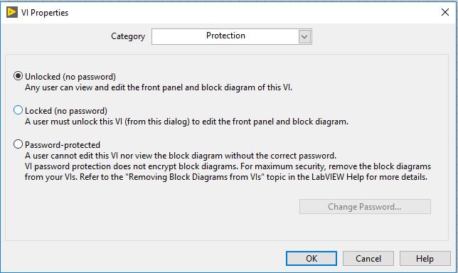

  2. The VI is locked: The VI can be locked with no password from the VI properties. To disable this feature just go to the toolbar menu click on File>>VI properties from the dropdown menu Category select Protection, and change from locked to Unlocked. This can be reviewed in the following image:
After changing this configuration you should be able to edit any component of the VI.
