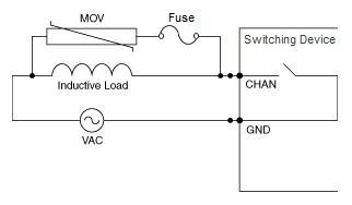

Since the power source can be either positive or negative in voltage, a single diode will not work to control possible voltage transients in an AC circuit. A common method of limiting voltage transients uses Metal Oxide Varistors (MOVs). This technique reduces voltage transients to levels defined by the rating of the MOV.
MOVs act to “clamp” voltage transients to predetermined levels. They are very fast acting and go from a very high impedance to a very low impedance in nanoseconds or less. It is important to size the MOV properly, however, for both the voltage at which it breaks down and the energy it must absorb. A rule of thumb would be to set the voltage rating of the MOV at a value 10-25% higher than the nominal system voltage. Another important parameter of the MOV is energy rating. The MOV must be sized to dissipate the energy stored in the load. This may be referred to as the “Load Dump Energy” or “Maximum Absorption”. The units will always be in joules though. MOV vendors will also specify a peak current, Ip.
Figure 2: AC Circuit Protection using an MOV
Other sources of transients exist besides those created by inductive loads. For AC circuits, this can be the power source itself. AC power lines frequently have high voltage transients that should be guarded against. MOVs can be used limit these transients as well.
Like all parts, they can eventually fail. MOVs usually fail as a short circuit. For this reason, it is good practice to include a properly sized fuse in series with the MOV. Figure 2 shows an AC system protected by MOVs. Another effective way to limit high voltage transients is to use a “snubber” circuit. Snubber circuits can be used for either DC or AC applications and provide an alternative to either of the previous methods presented here. Due to the variety of types of snubber circuits and their complexity, this method of transient suppression will not be covered in this KnowledgeBase.
