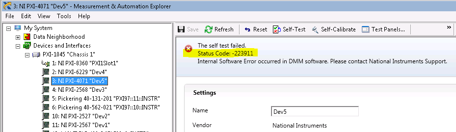

Error -223911 Occurred at Self-Test in NI MAX
Updated Jun 20, 2025
  • PXI-4071
  • USB-4065
  • NI-DMM
Why is my device failing when I run a self-test in Measurement & Automation Explorer (MAX) with
Error -223911 occurred at a Self-Test?
This error can occur after a DMM module alias is renamed. Restarting the Measurement & Automation Explorer (MAX) after renaming an alias can help eliminate this error.
Also, this error could occur due to a defective USB cable, for USB DAQ devices or USB DMM devices. In those cases, swapping the USB cable with a different one might resolve the issue.
