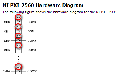

In order to use these functions and VIs, I need to know the names of the relays on my switch device.  Where can I find this information?
The relay names are located in the NI Switches Help. Refer to NI Switches Help if it is not already installed on your computer. In the NI Switches Help, refer to Devices » <Your Device> » Hardware Diagram. This hardware diagram will show the names for each relay on the module.
An example of the hardware diagram in NI Switches Help for the NI PXI-2568 module is shown below.  In this example, the relay names are K0 through K30.
