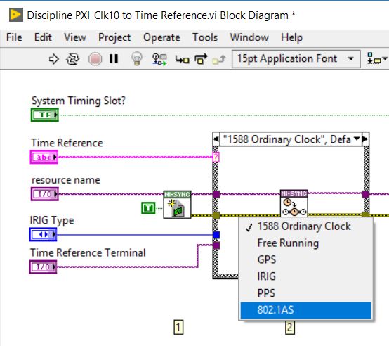

To configure through LabVIEW, refer to shipping example Discipline PXI_Clk10 to Time Reference.vi. The dropdowns currently do not include IEEE 802.1AS. You can modify the polymorphic niSync Set Time Reference.vi to use 802.1AS instance.
DiscipliningClock
