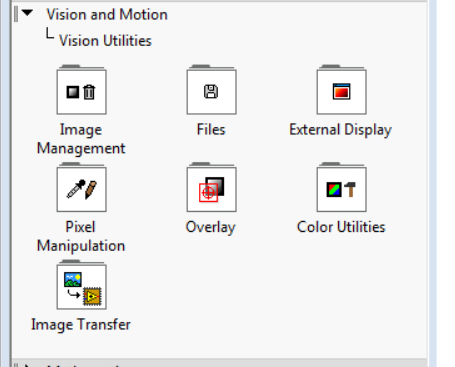

I'm looking under my Vision and Motion Palette>> Vision Utilities and seem to be missing the following Palettes:
Figure 1: Current Pallets
Figure 2: Required Pallets
The missing palettes are components of the Vision Development Module (VDM). This issue can be fixed by Installing the newest compatible version of Vision Development Module.
